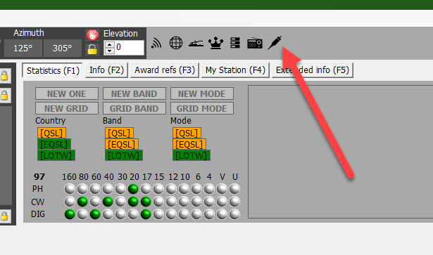

So you have selected OmniRig for Cat type in the settings and are clicking the icon on top to open OmniRig?
I am assuming you are trying to run the version of OmniRig that comes with Log4OM and not the version 2 of OmniRig?

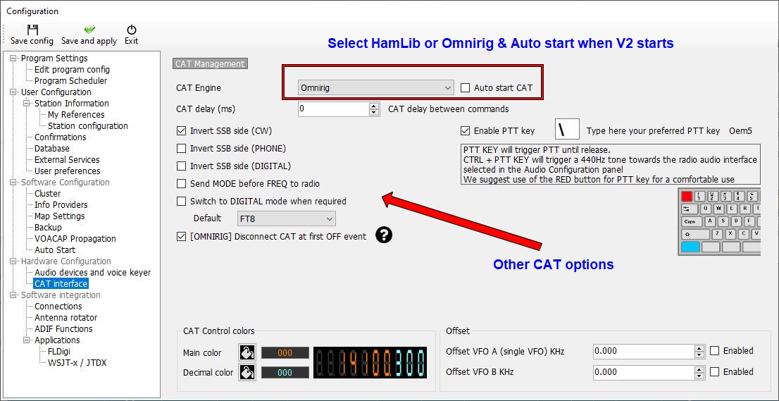

David,
Make sure you have done your initial CAT setup in the Settings / Program Configuration / CAT interface window. If you choose OmniRig then you also (once the V2 setup is completed) need to choose your rig and settings required there.
Rich's post is good as well, but won't fly until you have set up the underlying basics.
Did you have V2 do the OmniRig installation as part of the V2 installation ... or did you install it by yourself?
The only OmniRig that is supported by Log4OM is the original version that handles "two" rigs. There is an OM in Switzerland who has developed a version of OmniRig that can support up to 4-rigs, but we have been working with that developer to resolve many issues with his version and thus we're not supporting it at this time.
