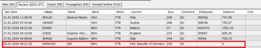

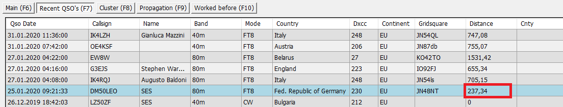

On my end all is fine, also editing the locator and the distance will be calculated. B.t.w. most time
we habe 4 digit locators from WSJT-X/JTDX but from time to time also 6 digit locators. Both showing
correct distance in my log. Only when no locator is provided the distance not eill be calculatet when
the QSO is logged ....

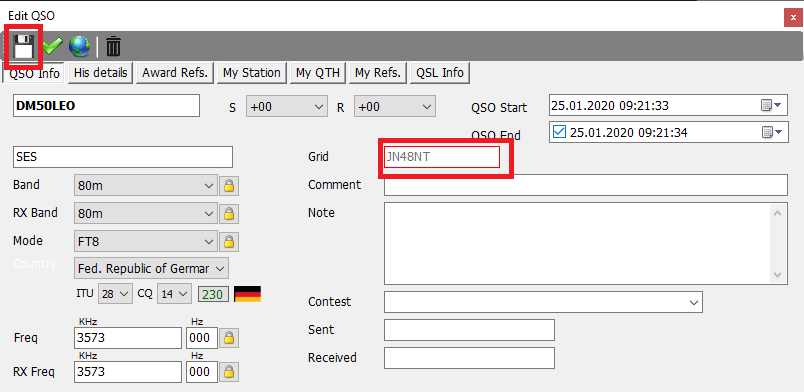

But if you can find out the locator and open the edit window you can fill it in. Hit the save button after
done and the distance will be calculated and F7 tab refreshes automatically ......
That was edited and after refreshing i see the calculated distance in F7
