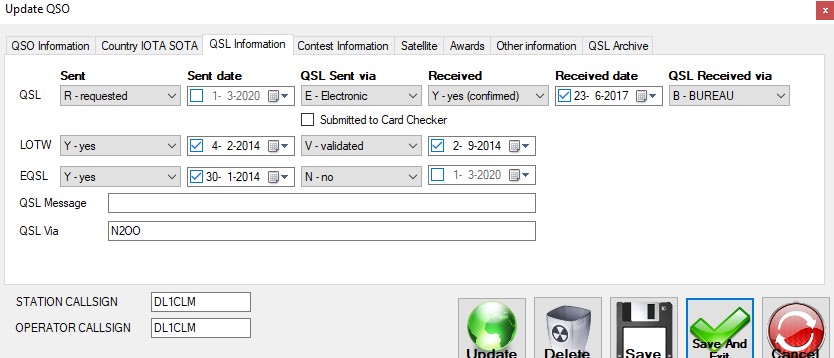

V1 LOTW status .jpg (56.31 KiB) Viewed 3056 times

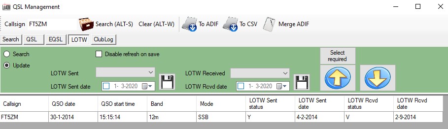

V1 QSL status FT5ZM.jpg (67.17 KiB) Viewed 3056 times

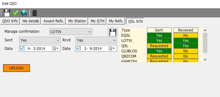

The same QSO with FT5ZM in V2
V2 QSL status FT5ZM.jpg (42.55 KiB) Viewed 3056 times

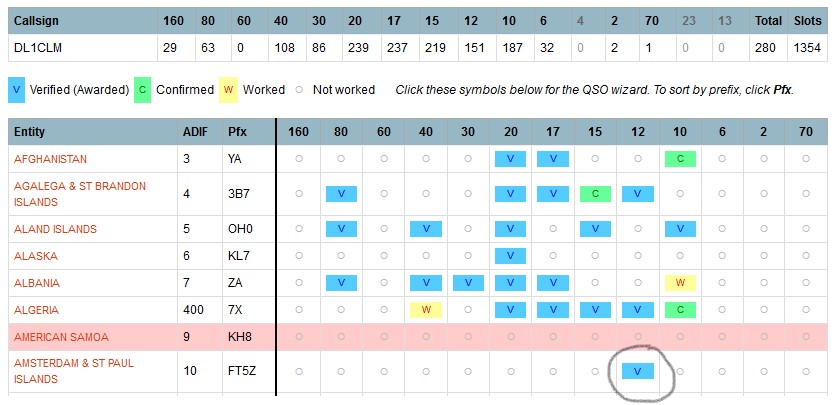

that's what it looks like on the DXCC charts in club logs.
After the upload from V2 all blue "V" were changed to green "C".
Clublog DXCC Charts.jpg (87.47 KiB) Viewed 3054 times
I hope this can be resolved very soon.
