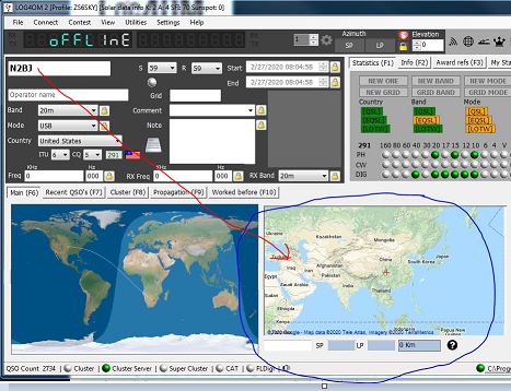

Well all was working fine, until last night, just a niggally thing, the "Google map display of the location of the other station entered in the call sign input field" just suddenly stopped working last night.
Issue, when a call sign is entered either manually or remotely from WSJT-X (FT8) the map on the right is suddenly no longer working, it just does nothing, it does not move, its supposed to go to the grid location of the entered call sign, that part is no longer working, I don't know why?
I noticed that the operators name is no longer coming up, my primary info source was qrz.com, I am no longer a subscriber, my prescription expired, not renewed yet.
I changed this to HamQTH as per advise on this forum, this didn't help.
The only thing changed last night is that my logs were not getting uploaded to LOTW, so I checked the path, and changed it slightly, so its working now, on manual uploads, but doesn't seem to be doing it automatically, I logged two qso's on FT8 last night, but they did not upload to LOTW on exiting LOG4OM2
See attachment

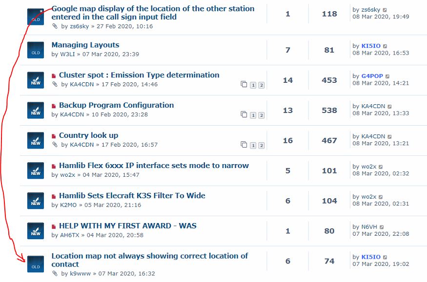

Re: Google map display of the location of the other station entered in the call sign input field
Please see other post, its the same as my query & offers a solution
If there is not a grid reference in the grid field the map position cannot be calibrated
Something is wrong with your lookup to on line services
