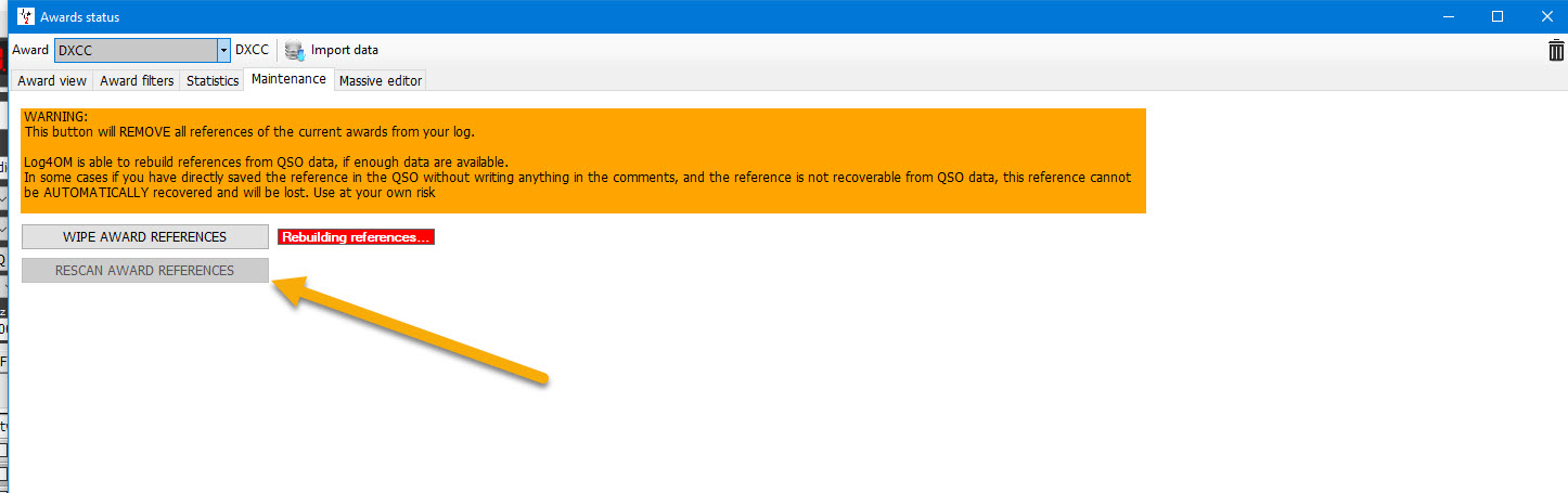

Couple things. Go into Award manager again and add your 60 meters (again) and go to the confirmation tab and set the two sections the way you want them.
Once you are done with that and its saved go back to your award stats and click the maintenance tab. Rescan the award references.
See if that does anything. Right now these upgrades are wiping out the award settings. Until Lele fixes it we are going have to deal resetting that each time.
Rich
