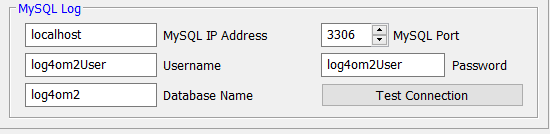

Hi Hamad, I would also like to install MYSQL since I have over 182,000 QSOs. Did you figure out how to do it? The setup is asking for a MYSQL address? But I do not know what to enter. Hope all is well. I wish Log4OM2 would provide step by step instructions. 73, Dave, N4QS

Greetings Hamad et al.
I had already my own learning curve,
therefore decided to share my experience.
Uploaded to dropbox.com:
- MySQL-8.0.20-Log4OM2.pdf
- 28 pictures
describing step by step MySQL install routine
and import into it ADIF file with a lot of QSO's.
Here is link to files:
https://www.dropbox.com/sh/wfsehypeg1jy ... UxWta?dl=0
Text above in Italics and Bold (including link!) is __NOT__ valid any more.
Instead, relevant tutorial was integrated by Log4OMv2 developers into official Log4OMv2 Manual.
Chapter: "Installing MySQL-8.0.20 with Log4OM Version 2 by Tom - SP2L"
Hope that helps.

One thing I would add, if you are planning on using JTAlert, on your image MySQL-10 select Legacy method and set JTAlert to

This MySQL instructions are to the "letter." I've just did mine.
Thanks for providing valuable improvement.
