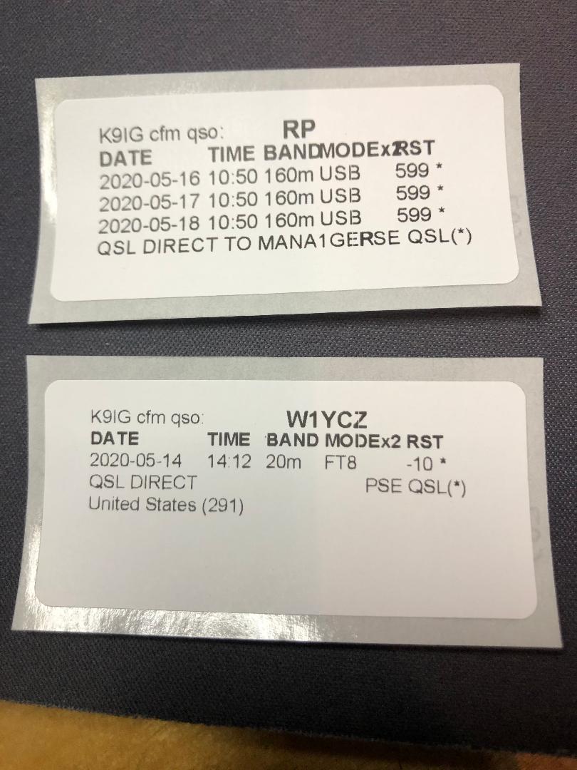

Issues with labels – saving label info (font size and printer selection)
Trying to print labels here, but nothing that I define is ever saved during the process – always reverting to the default settings resulting in labels with font too small to read.
1 – Utilities>Label Definition
Load Label – I select Brother QL750
Label Properties – I change Font size = 11 / Change Max Address Font size = 12
I return to Page Layout tab > TEST PDF > ADOBE spawns – I select label size > Print = ALL is GOOD
I click the FLOPPY/SAVE
I close Label Definition
Now – I want to PRINT a label for a QSL:
Utilities>Label Print
Find the QSO that I wish to print a label for with no issues – Confirm Selection, review on Routing Tab > Click GREEN Check on right side of screen to confirm all is good > proceed to PRINT Tab
On Print Tab:
Step 1 – My Printer is NOT selected – I must open drop down and select Brother QL750 – if I click EDIT for my QL750 – Label Definition box opens and NONE of the INFO ENTERED PRIOR is SAVED from step 1 above – Font Size is now 5, Max Address Font Size is 5
I edit font size – but it never SAVES.
Step 2 – I go ahead and check Print Direct only
Step 3 – I click PDF Print button
Adobe Reader spawns – I select correct size of label and print – font is SIZE 1
What am I doing wrong here?

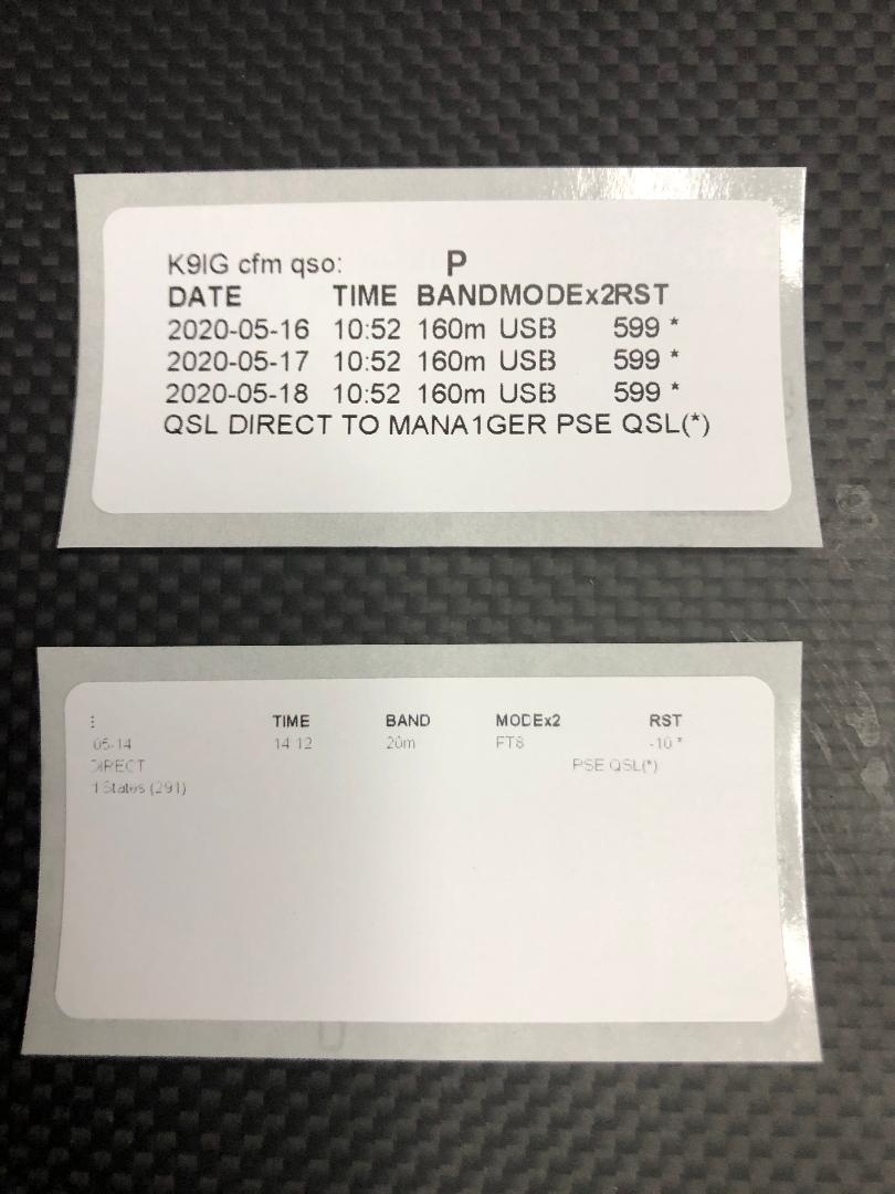

Attached is pic of TEST label (which is fine but wont save) and then an actual PRINT Label if I follow the print procedure in manual and videos.
Greg
K9IG

I still do see some differences in the TEST label on the top vs the Final Label on the bottom. Is there something else I should be doing in the configuration to insure that the fonts remain constant from TEST to "Production" mode in the Print Label section?

I would just tweak the settings in your 'named label definition' and keep testing to a PDF view. Then select just one or two Q's to also print to a PDF view (that way you don't consume/waste labels) for comparison.
It will take some back/forth to get things set. I've been through that some time ago. I use Avery labels as I don't have a 'label printer'.
BTW - Terry has posted a work-a-round for using a field in the QSO as the default "pse qsl" is still present. Do a search on the Forum for that suggestion.
