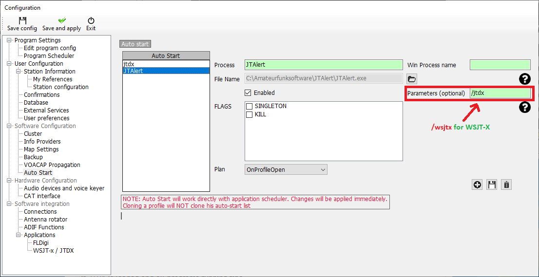

Re: Autostart launch of WSJT-x and JTAlert
You´re right Nolan but Log4OM autostart facility can´t handle the icons. I´ve tried to use the
parameters field in the autostart with /jtdx or /wsjtx and that works. I have
the error message too but it goes away if JTDXis completely loaded and JTalert is running
without problems.
No other suggestions possible. There is no delay possible at the present time. As i mentioned,
i have settet up to start JTDX and JTalert in Autostart. After Log4OM was loaded it starts JTDX
and JTalert. The popup comes up that JTalert can only start if JTDX is running. The popup leaves
if JTDX is loaded and all programs running fine.
Looks like everything is in order to run ... except for a "delay" (of sorts) before JTAlert gets kicked off to run and load.
If I run JTDX or WSJTx and JTAlert (no Log4OM V2) I have to first start JTDX and WSJTx. Once they are running I can start JTAlert. JTAlert hangs/waits for WSJTx or JTDX.
So ... Juergen ... we need to see about a Mantis item to add an option for delays with such parameters. That way we can add it to the "to do" list for a future release of Log4OM V2.
It´s on Mantis now. Have to go to work ... bye. ;) ;)
