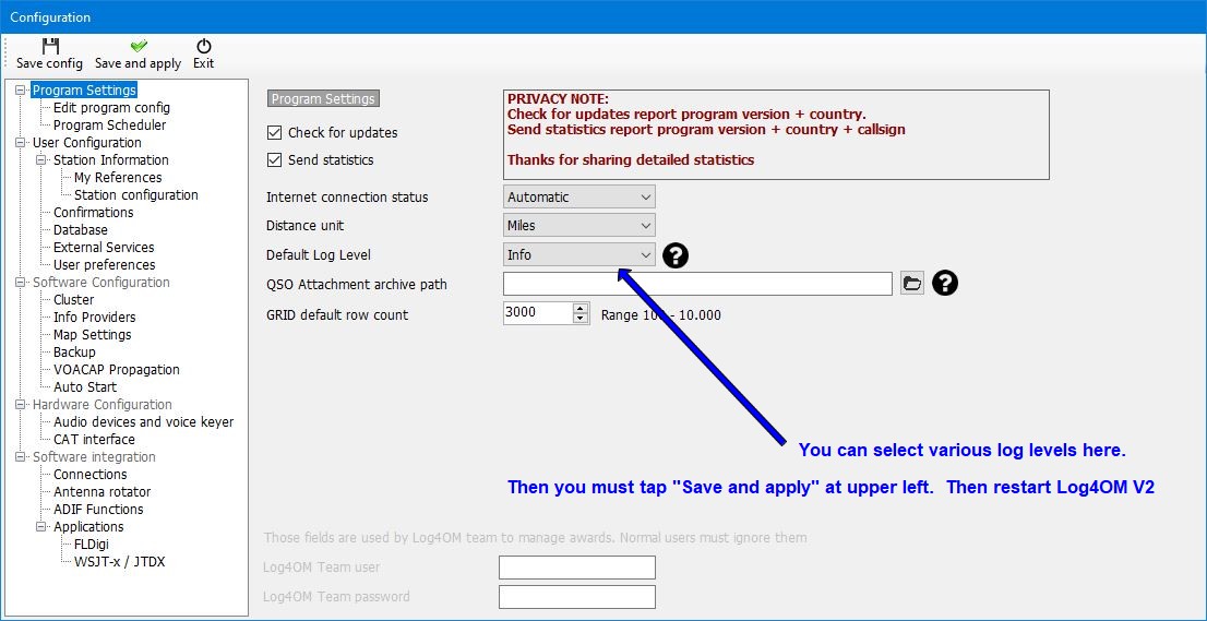

You can select the "Trace" level log in Configuration and run until your problem occurs again. Then some data might be available for you to view.
Albeit ... keep in mind that running Log4OM V2 full-time in Trace mode will very likely cause it to slow down in overall operation.
Check image below for setting Log Levels.
- config-pgm-settings.JPG (112.68 KiB) Viewed 6165 times
