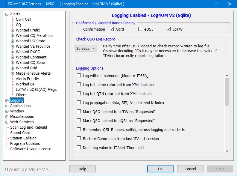

Posts: 11625
Re: LOTW status from WSJTX via UDP gets "requested" status
Please ensure that these logging options are NOT selected in JTalert
