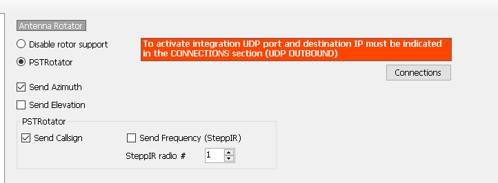

I have tried several different configurations, and can not get communications from Log4OM 2 to my rotor via PSTRotator.

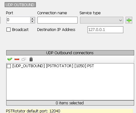

First of all you dont have the outbound connection to PSTRotator checked - Your second image!
