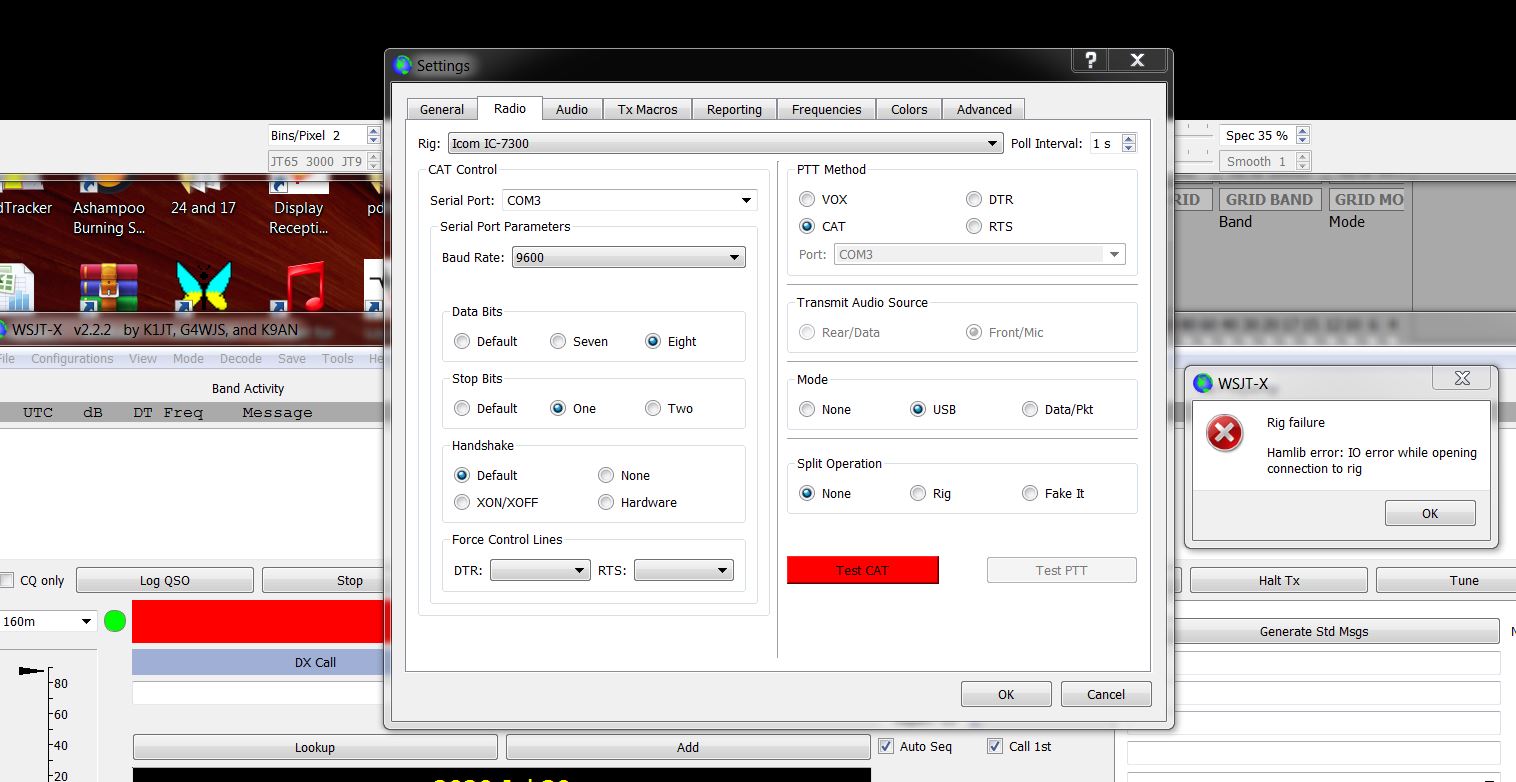

Hello I have spent weeks trying to get it to work but its beat me. I have read so many files & watched so much YouTube Vids. But I am going around in circles. On the version 1 of log4om all worked a treat.

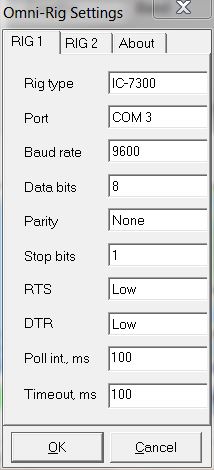

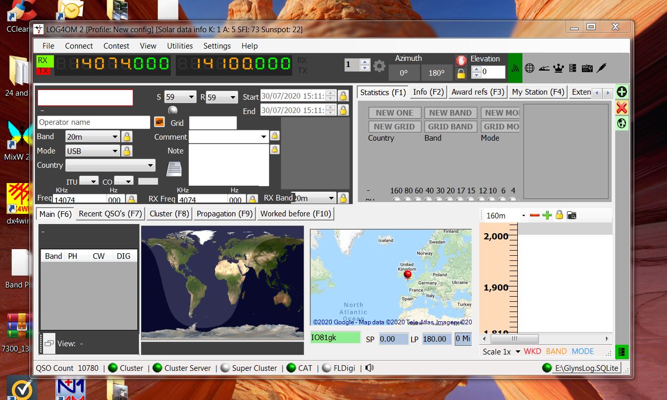

I can get Log4OM2 to connect to my IC-7300 as per screen shot on its own. Also I can run WSJT-X on its own and have QSO`s. But I cannot get them to talk to each other.
I get a rig control error notice.
I have attached screen shots.

Have you run all softwares like Log4OM V2, WSJT-X and Omnirig running as administrator ? If not only
one program can connect to CAT via Omnirig. Log4OM starting Omnirig and getting CAT control, if you now
will let have WSJT-X also having CAT control it can be connect to Omnirig that have an instance with V2.
Only with administrativ privileges in all softwares that are used for CAT Omnirig can use it´s multithreading.
So please check:
Omnirig (run as administrator ?)
Log4OM V2 (run as administrator ?)
WSJT-X (run as administrator ?)

Change WSJT radio setting to Omnirig rig1, not the Icom selection as in your screen shot
Ensure that all software that is using Omnirig is installed to 'Run as an administrator'
