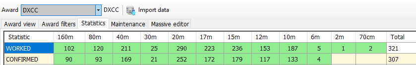

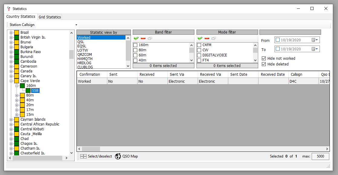

I am missing a lot of QSOs in my Awards statistics. I tried to clean and rebuild, but the operation did not help... What would be the issue?
Below is an example with 160 m, station D4C, shows the reference, but not listed in the DXCC award statistics...

Does Cape Verde show in the statistics view as worked on 160?

A1. Yes, it is visible as worked.

Claus, thanks for testing it!
I can confirm the behavior! It works, but only with DXCC, but nothing else's selected. Any additional filters messing it up! Now my "Confirmed" are the same with Clublog. This is a bug...
