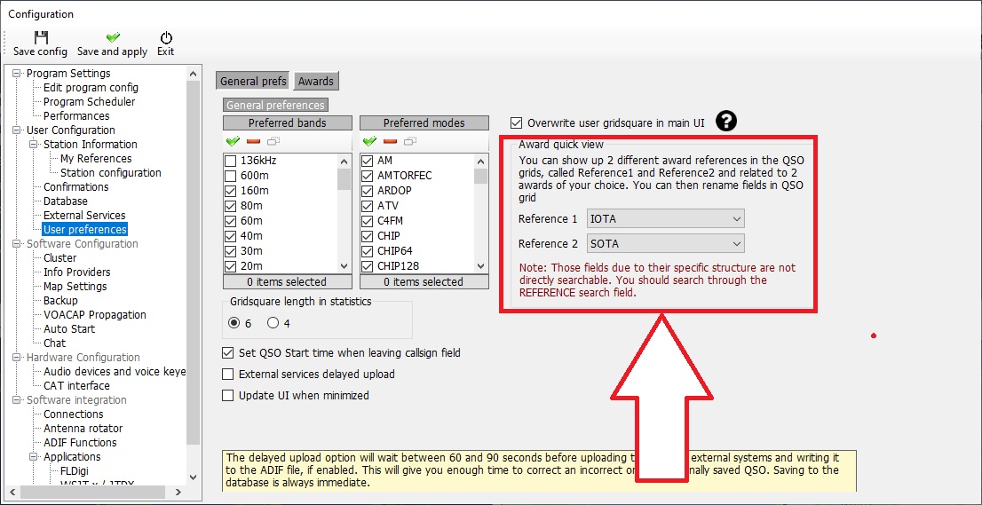

2) I have not seen the possibility in this part to export the "IOTA" field, I do not see how to display it also in the Logbook part (F7); it seems to me that we cannot directly display the IOTA in the Log or am I wrong?

Item 2 - Page 29 refers

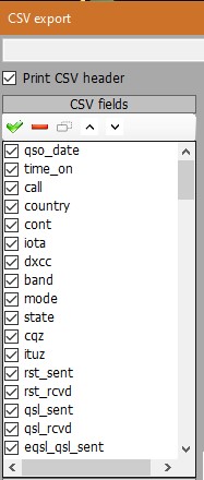

1) I changed the name of some fields in my logbook to put them in French
I see a single date field which in fact contains the date and time in the same field, is it possible to separate to have in the date field only the date and have a "Time_on" field which will contain only the time of QSO.
because when exporting in CSV format via the "Utilities / QSO Manager" menu, we can clearly see this "time_on" field
2) I cannot rename the field names for the export as I did for the logbook; wouldn't it be possible to do it
for example in the LogBook I put IOTA in the "reference1" field and rename this Field "IOTA" because this field does not exist in the Logbook but exists in the export in CSV format
3) I'm missing an "index" field that would contain the QSO number (QSO_Number). This number would of course be sequential from the first QSO and should be able to be recalculated if for example we add a QSO
4) I have selected all the fields I want to use for the export and I have positioned them at the top of the list to easily find them
Unfortunately Log4OM does not memorize my filter (although it does very well for example during a search filter) so each time I have to rebuild my filter.
Wouldn't it be possible to save the filter ?

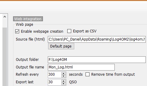

I continue to test the Web Integration system
you can see what i created from the log on my site (http://f6flu.org and select "Mon Log" in the menu)
In the Log4OM Webmenu it is possible to choose the update interval (by default it is 300 seconds) but if I put a smaller value, Log4OM does not take it into account (for example I put 60)
