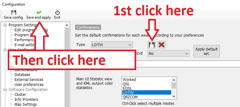

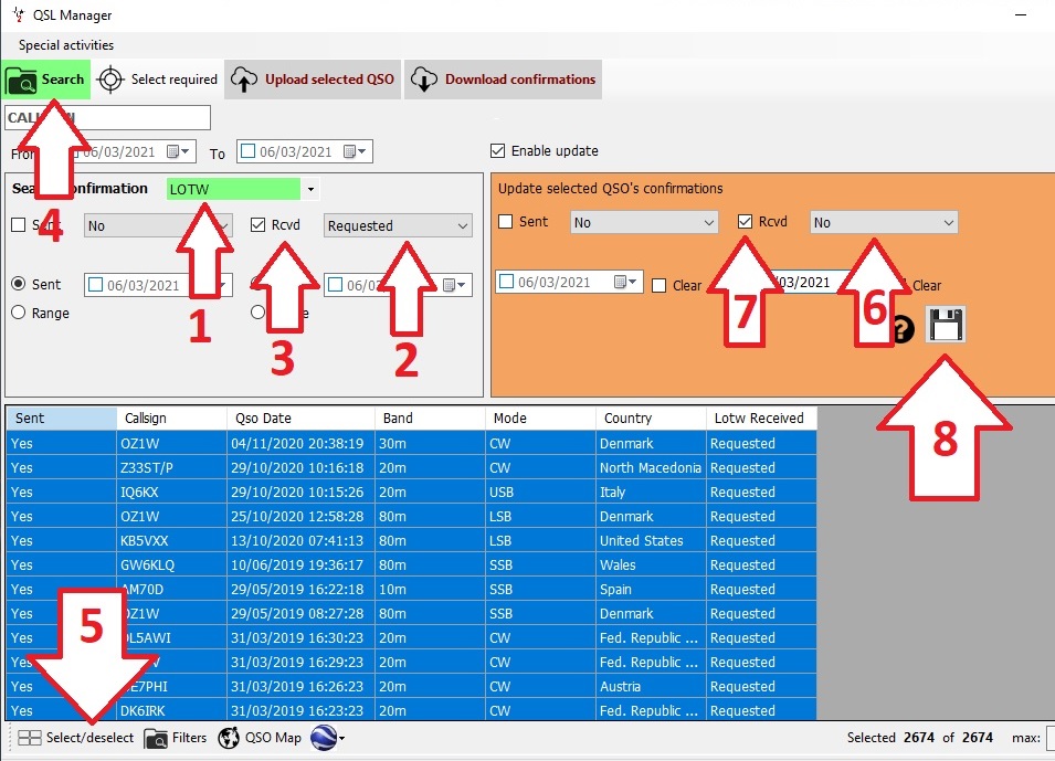

Hi I looked at configuration videos 2 and 3.Maybe the question I need is in video 1 but I can't find it at Youtube. I tried setting the defaults for the QSL manager page and for some reason it doesn't have an effect.Also still trying to figure changing the QSL status on multiple QSO.

rg70 wrote: 06 Mar 2021, 02:29 Hi I looked at configuration videos 2 and 3.Maybe the question I need is in video 1 but I can't find it at Youtube.
Think you mean 'Confirmations' not Configurations so its here https://youtu.be/7yuxJhVEFFI
The setting should effect new QSO's added after you changed the setting not historic ones
After changing the settings did you
Re: Confirmations
rg70 wrote: 06 Mar 2021, 02:29 Also still trying to figure changing the QSL status on multiple QSO.
All in the user guide and confirmation videos but here is a step by step again
