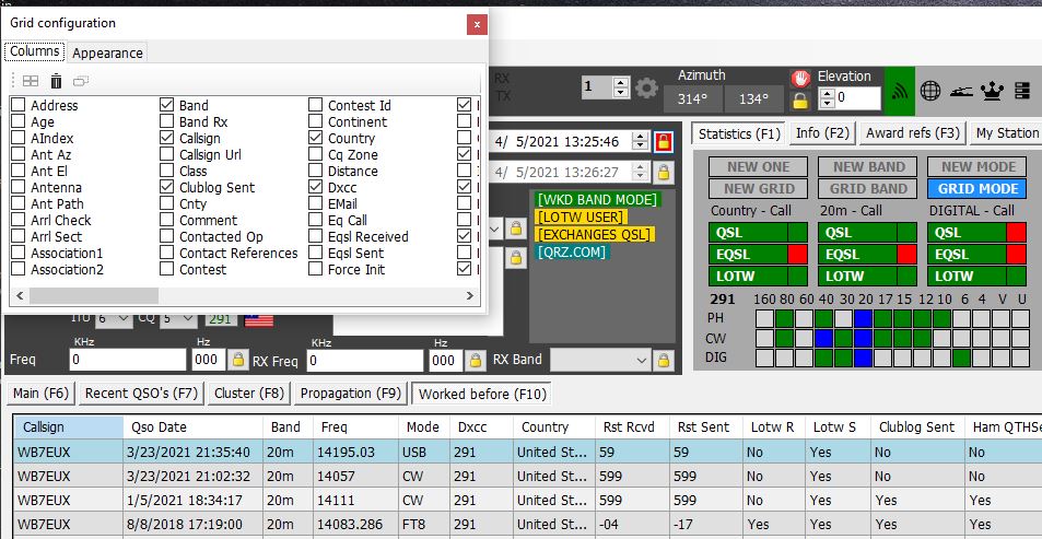

ich finde keine Möglichkeit, die Ansicht von "worked before" OSO's zu konfigurieren.
Gerade die Spalte ""Comment" lässt sich nicht anzeigen.
73', Stefan

With the Worked before (F10) panel open ... right click on the visible column labels and select: Edit table layout.
Another small edit window will appear and you can tic the boxes for the labels/columns you want to appear. Each grid in Log4OM V2 has this option.

With any grid panel open you can left-click-hold the column's label and move it left/right where it best works for you. You can also resize the width of the columns.
Works the same as the Excel spreadsheet in Windows when it comes to moving columns, resizing, renaming, etc..
Each grid's adjustment are for "that grid" so each can be personalized.
