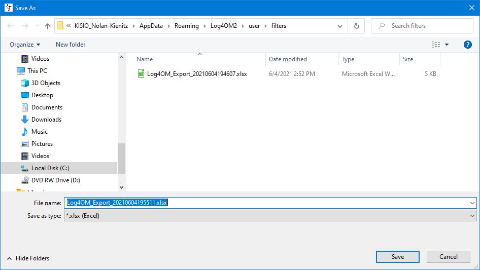

I just stepped through the filter creation, selection of QSOs and save process. This to be sure I was seeing "where" I was saving the filtered results to an "excel" file.
I did my filter/selection from the QSO Manager and should have pointed me to the same location.
So ... check out the location under your username / AppData / Roaming / Log4OM2 / user / filters
Whatever you named the file you saved should be located there.
You could (via your 'file manager') double-click the file and the 'excel' equivalent in Open Office should open/convert the file.
I use LibreOffice and have no issues opening any MS Docs.
UPDATE:
I just built a filter from the Recent QSO (F7) tab and saved the resulting file to the same location I noted above. I can also open the file in LibreOffice FB.
Image below is a screen clip of my path and the file being saved.
- Filter-save.JPG (58.31 KiB) Viewed 3938 times
