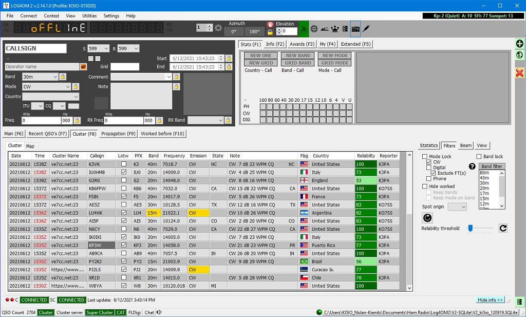

I don't often use the SuperCluster, but have turned it on to run with my ve7cc cluster feed. When I first turned it on the data columns you noted were not great for feeds from both clusters so I pretty much set it aside to being the general lack of good band/solar conditions.
I've kept both clusters running and just grabbed a clip from this morning's feed and all seems to be working FB as best I can determine.
My Threshold slider is barely two clicks from the full-left side whatever percentage that relates to. I've often just left the Threshold at the full-left side.
Check again today and let me know if your values are any better ... or 'not'.
Image below has feeds from both the ve7cc cluster and SuperCluster. I have the Cluster Name column noted in my display and you can easily see ve7cc.net:23. The partial view (limited by my column wide sizing) for the SuperCluster is: https://www.... .
Both seem to be showing valid data.
