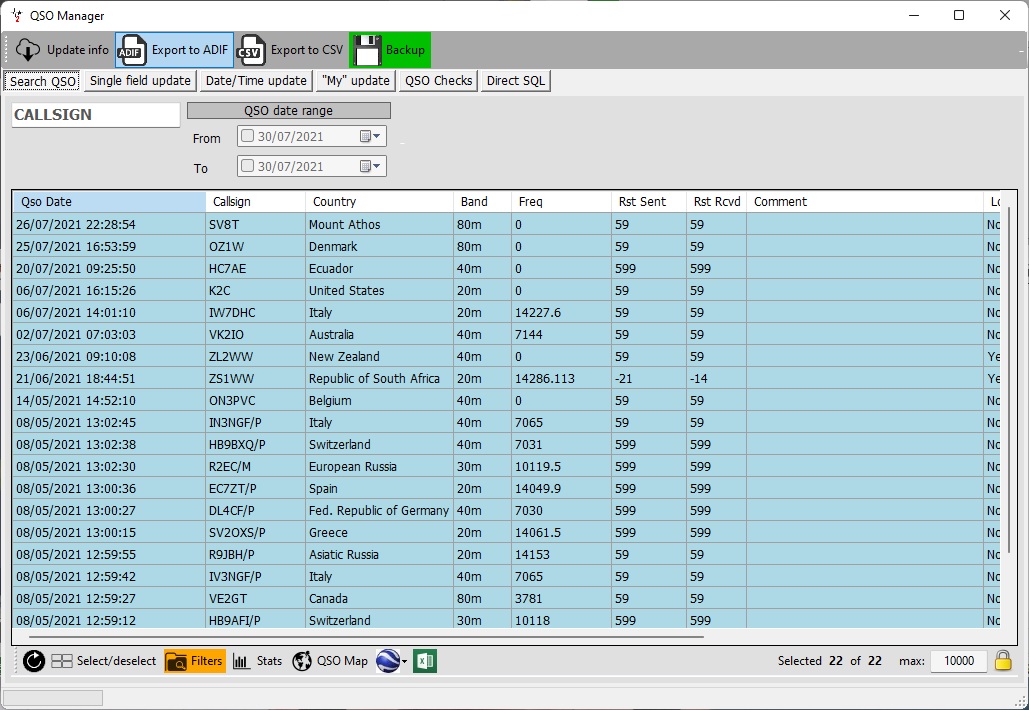

However you can currently use QSO Manager and select the appropriate QSOs and create an ADI file for your use.

So he has to use QSO Manager to create an ADIF for uploading manually to qrz.com and he must
do this via the qrz.com page if he is logged in.

Not required because it can be done in the QSO manager
Re: QRZ.com log, manual QSO upload/download
this is what I usually do, export adif with last QSO and import it manually into QRZ.com.
