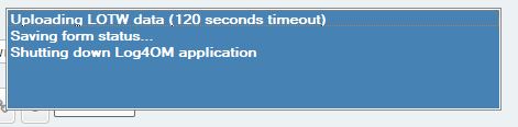

Hi, when i am clossing the program it hangs up and not closing, i have to go to the Task manager to close the program. Perhaps i made wrong settings.
I am using an FTDX3000 with Omnirig version 2.16.00 and Windows 10
Thank you for comments or advice

Have you tried un-setting automatic upload to LOTW on closing?

Hello, than kyou, yes i unswiched the automatic upload from LOTW and now all is fine.

We think its a recently added switch to the LOTW auto upload but cant check until Lele comes back from holiday in a couple of weeks

I’ve also experienced this problem several times. I usually wait about two minutes, right click, and close the window. It’s very unpredictable, but not a major concern.
