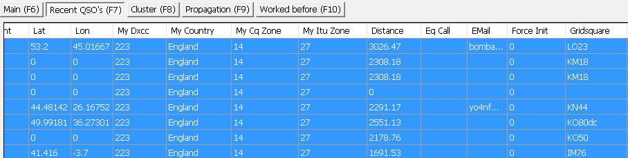

Do all QSO's contain a 4 or 6 digit QRA locator? this is not shown on your screen shot

Not all do, see attached.

M0ZEH wrote: 19 Dec 2021, 20:51 Not all do, see attached.
That could be the reason because the Google kml file is calculated using the grid square

I confirm if I select 2 qso with 6 digit grid square it plots fine on google earth.
Thanks Steve M0ZEH

If you select 3 qso, first one 6 digit grid and other two 4 digit grid only the first one gets plotted.
Thanks Steve M0ZEH

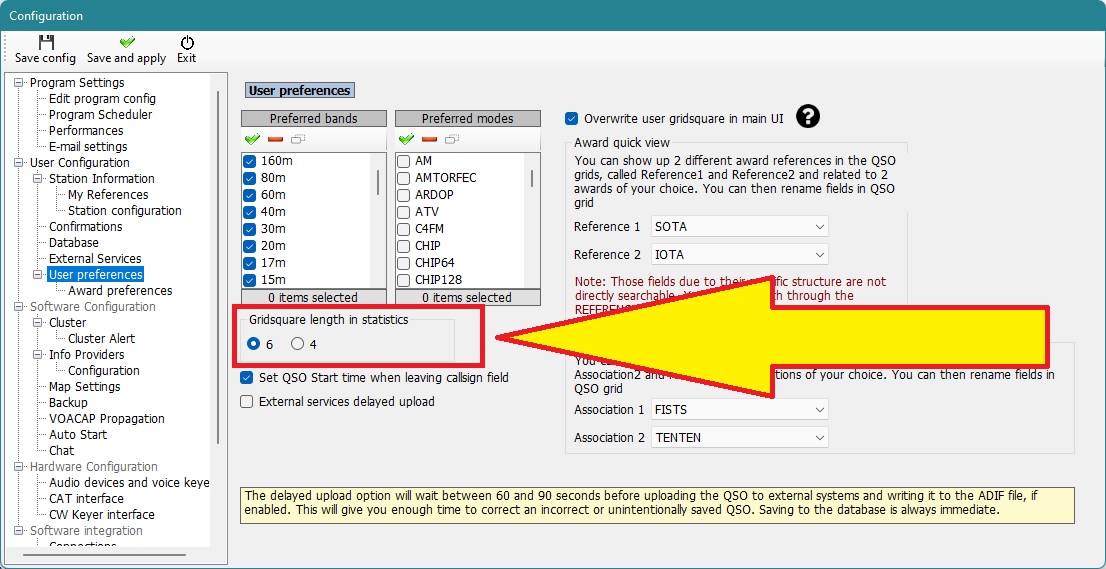

It was set to 6 but the preferred bands were unticked so I have ticked them all now. The grid is shown in the window as 6 digit when I reply to an FT8 call but when JTalert logs the call is goes to 4 digit.
Thanks Steve M0ZEH

I can confirm that grids with 4 digits do not get plotted to Google Earth.
