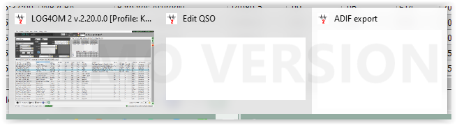

Hi guys,
I got a new PC running Win10 Pro and installed the latest Log4OM, copied all the settings from the old PC and imported latest ADI file from QRZ (lost all my contacts on the old PC). Now there are no addresses in the ADIF file from QRZ. Right click on QSO -> Edit QSO and nothing. The edit window does not show. Same with ADIF export. What I can see is in the taskbar a white empty "preview".
See attached PNG. Any Ideas?

Hope that clears some misunderstandings.KI5IO wrote: 26 Mar 2022, 17:03
Your combined images are too small to view to get any hints/value from.
-> The Image is a screenshot from the Taskbar, the "preview" you get when you move the mouse over the "app" in question.
-> Sorry, this is as big as it gets. The main point here was to show that the "Edit QSO" and "Export Adif" are blank.

-> Problem is: I can not get the EDIT QSO window to show. It does not come up and the Preview in the Taskbar is "BLANK".

Hi OM's,
Found the problem. Was the Video driver for a WAVlink USB-> VGA external Adapter. I have a 3 Monitor setup, Mon1 and 2 on a videocard that can run 2 Monitors and Mon3 on the external USB adapter. When I select the USB as "main" monitor, the Edit QSO and Export Adif window do not come up. Once I selected Monitor 1 on the internal videocard as "main" Monitor, the problem was gone. Go figure. No clue why.
