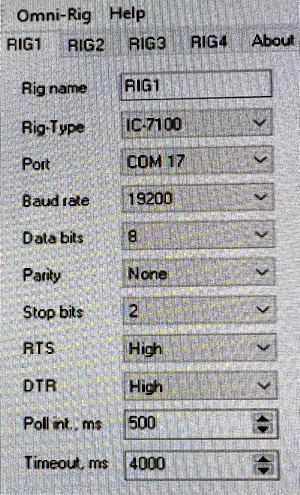

By the way Simon,
my G90 runs with Omnirig with the following settings:
Change the COM Port to your´s ....
Re: CAT control via Omnirig (Xiegu G90)
Thanks Juergen,
I’ve seen you post these settings before.
In fact both these seem to work equally well.
Do you know what the differences mean?
73, Simon
Think RTS & DTR are only needed if a software switches PTT. If not there will be no difference between High or Low. That's what I think about it.
I realise that Terry. Was just highlighting that on the 2-tab version, Omnirig works with 1 or 2 stop bits selected, and RTS and DTR set to low or high. I wondered what effect these settings have.
Shouldn’t have included the Swiss screenshot, but the settings highlighted also work on the older version.
RTS and DTR were from the old times mostly where you used a serial com port on your PC. With USB in most cases these settings are obsolete.
