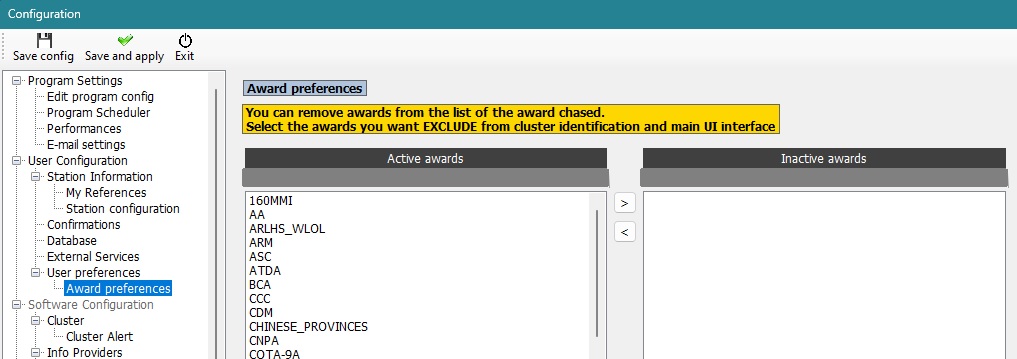

I see this error in the log not sure this is relevant.
As you can see they all are active.
The problem is I see no reference, this is for example for WAS award
Thus in any QSO with USA when I am in award tab the dropdown list to chose the state is empty.
