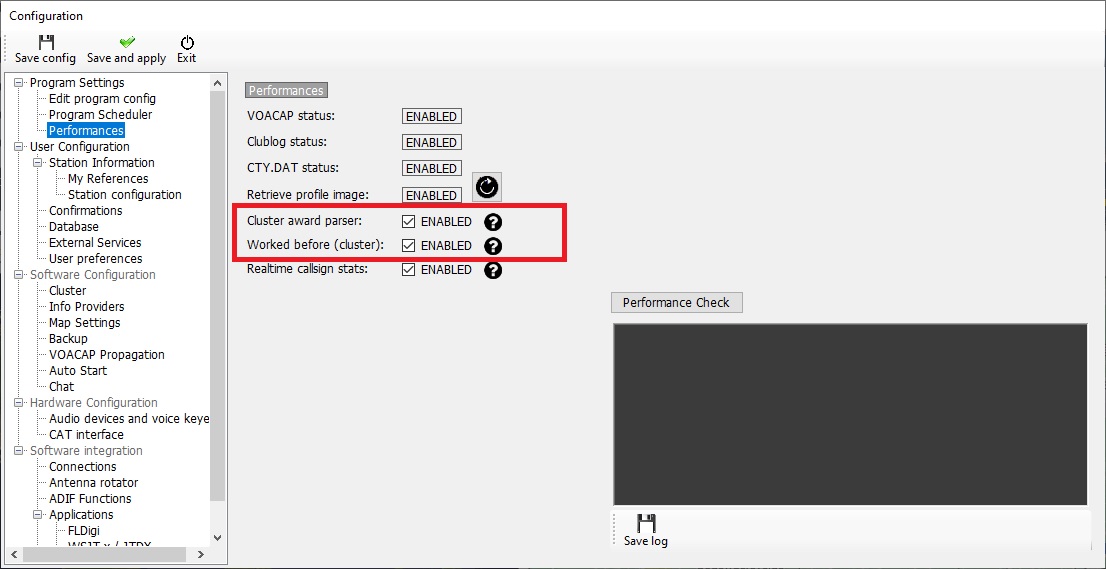

Try unchecking these two boxes and see if that improves things

Post by KH6CT »
You are a MASTER of software!! Unchecking both solved the problem.
Thank you very much....
Best 73 and Aloha... Steve KH6CT
