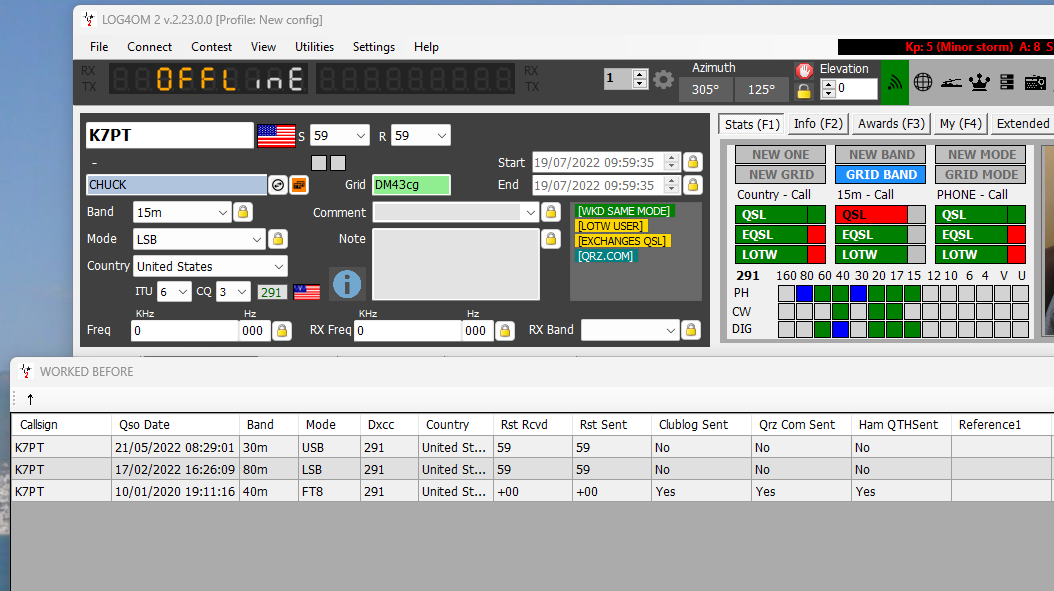

Well its working fine here, see image below.
Antivirus, firewall or something local blocking?

WKD SAME MODE and WKD BAND MODE is working OK,
Problem is only witch WKD SAME MODE GROUP and WKD SAME BAND/MODE GROUP.
I noticed that when I save a QSO, the WKD SAME BAND/MODE GROUP changes to WKD BAND MODE and the window already appears.
