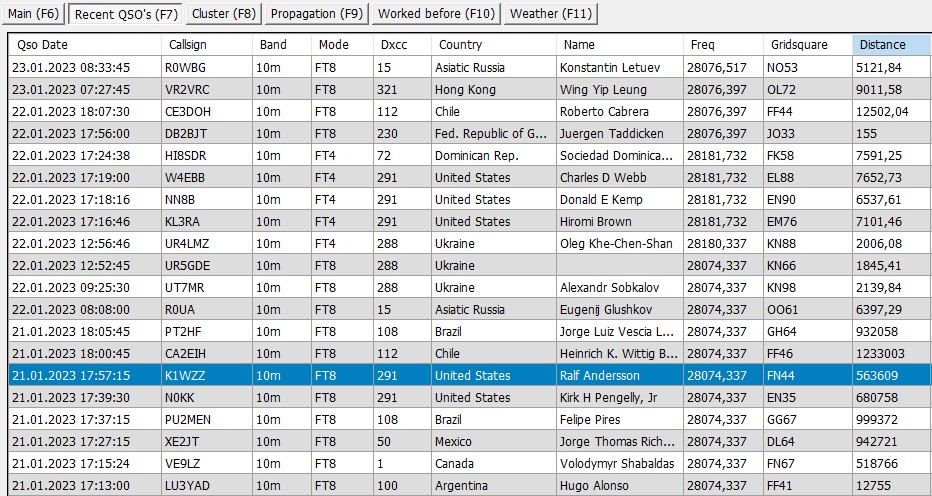

After the import several distance values are incorrect as you can see in the attached screenshot..
It seems that the comma is not set before the last 2 digits.
When I open the contact and save it again it is corrected.
Is there any way how I can correct it for the whole log without opening every single QSO?
These values probably came from the import, not calcualted by Log4OM
Easy to fix go to
QSO manager
Select the QSO's to be edited
Bulk edit the 'Distance' field to be empty/blank by using 'Single field update' (Field to update = Distand and check 'clear field' followed by 'Update'
Finally still with the QSO's selected/highlighted use 'QSO checks' tab in QSO manager to update the distance/bearing
Dont forget to un check 'Simulation' or nothing will be changed
All of these steps/updates are in our user guide

That works, many thanks
