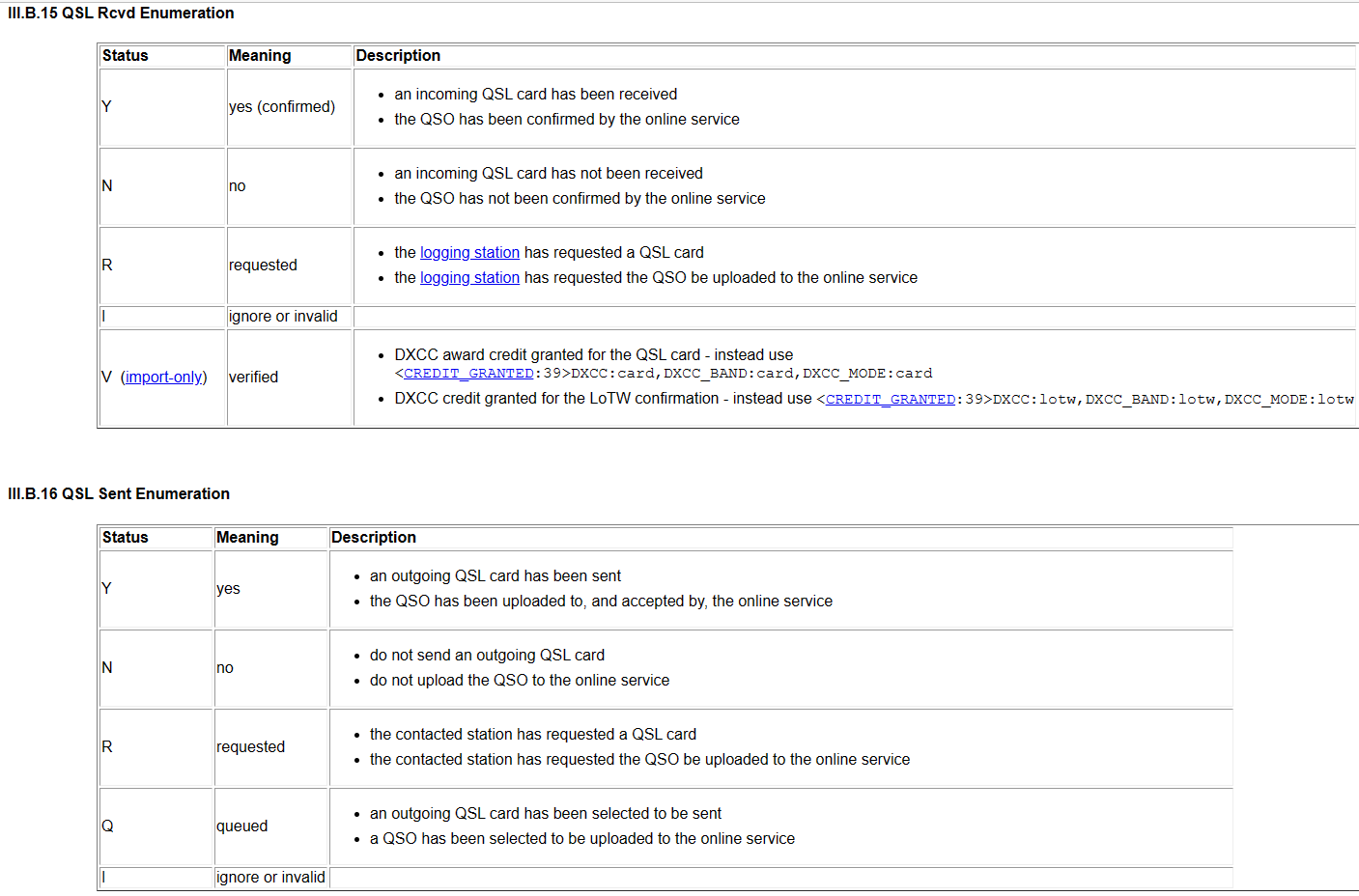

Below is an image of the authorised ADIF received and sent enumerations
All you need to use is Y or N and probably V if your interested in LOTW/DXCC awards, forget the rest
ADIF ENUMERATIONS.png (74.61 KiB) Viewed 1153 times
You get confirmation for past QSO's by being registered with LOTW and eQSL and using our QSL manager to download your confirmations or by sending the other guy a QSL card and receiving one from him

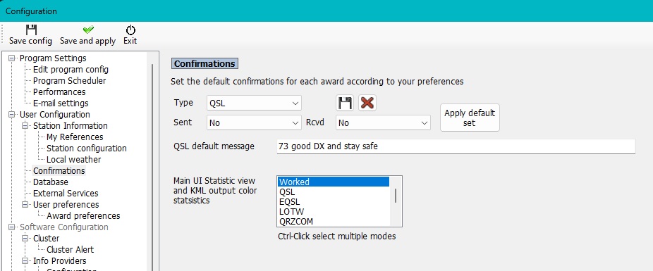

Just use N and N for each type of confirmation and emulate the settings shown below
Important that you click the small floppy disc icon to right for each type and Save and apply when done
Confirmations 1.jpg (79.85 KiB) Viewed 1142 times
Confirmations 2.jpg (131.71 KiB) Viewed 1142 times
