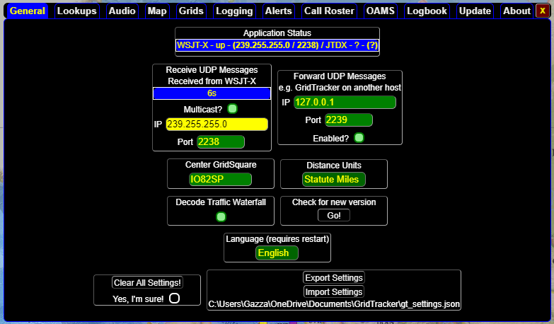

Add the grid square directly from wsjt-x/digital software as a lot of the time the grid square logged is incorrect. it is so annoying that your contacts give their grid square but the incorrect one is logged after finding this out recently I now have over 5000 contacts to go through to check and correct :oops:

Actually logged incorrectly or displayed in lookup incorrectly?
How are you retrieving qso's from ft8 software?

they are incorrect in the green highlighted box and also if i correct it before its logged it still logs the incorrect grid square

wsjt-x outputs on udp and is picked up by gridtracker then forwarded out to log4om
Posts: 11582
Re: Grid Square logging
Your sending the data twice, try unchecked the enable box you show in the jtalert screen shot above and check that logging to log4 on is set in jtalert logging window
The display in log4om is incidental just leave it alone because the udp connection does it all no need for you to do anything in log4om

G4POP wrote: 26 Jan 2023, 19:44 Your sending the data twice, try unchecked the enable box you show in the jtalert screen shot above and check that logging to log4 on is set in jtalert logging window
there isn't a jtalert screenshot there???? the 1st one is log4om then gridtracker

Sorry gridtracker
