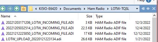

Roger,
Did you ever set up your temporary folder for LOTW uploads?
Images below show that field filled in on my installation as well as the path I made/use for the temporary path files.

Roger,
Be very careful of the location where you create the LOTW/TQSL/Tempy folder.
Put it under the Windows IS default of: My Documents or Documents
Look at my screen clip with the path to that tempy folder. That ensure the folder in that directory structure can be properly written to and read from.
Do NOT put it in the same folder where you have the TQSL operating programmed installed. That will give you headaches.
Other drive locations outside of your system's C: drive will also give you headaches.
