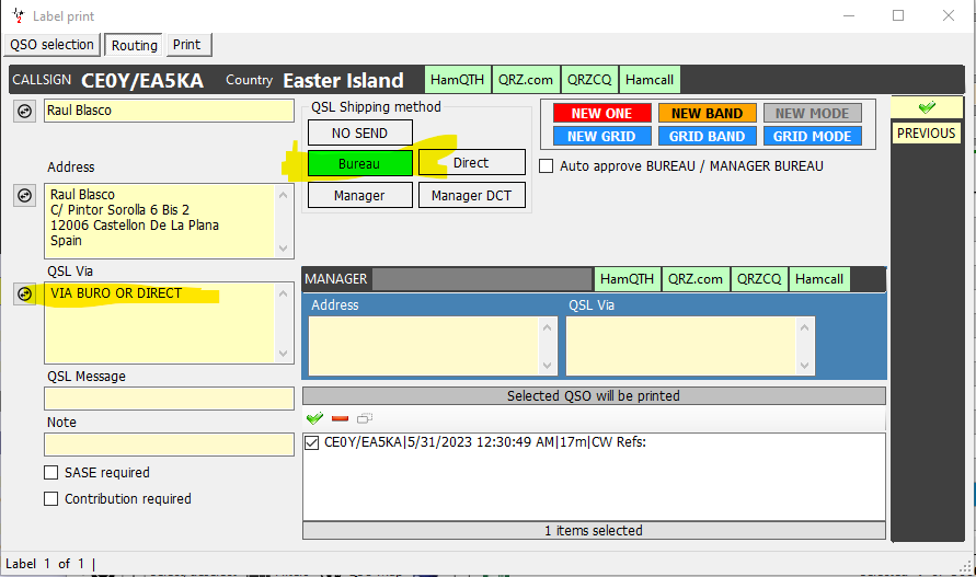

I can not get the address label for Manager DCT (direct) to print. I am trying to a card for CE0Y/EA5KA. When I select the log entry and go to Routing, QSL Via is set to VIA BURO OR DIRECT and Bureau button is green.
Screenshot 2023-05-31 143756.png (43.79 KiB) Viewed 1191 times
How do I set the QSL manager info? He states his manager is EA5KA. If I enter that into the 'QSL Via' box it doesn't help. I can't enter it into the field left of MANAGER. I have a QRZ XML subscription.
So no matter what I do, if I select the "Manager DCT' option and click QRZ.com, nothing gets filled into the MANAGER Address field.
Screenshot 2023-05-31 143953.png (52.67 KiB) Viewed 1191 times

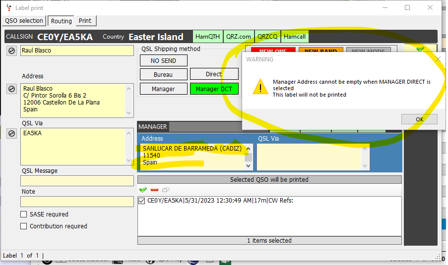

If I enter the Manager's address (EA5KA's that is) into the MANAGER Address field and press the green check mark to move on to the Print dialog, I get an error saying the Manager Address can not be blank.
Screenshot 2023-05-31 144131.png (61.14 KiB) Viewed 1191 times
How do I make this work? There isn't much information in the User Manual (Updated: 23/03/2023 9:15 PM).
