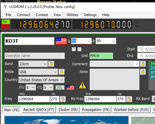

Club is W3HZU and after thr updates still only get FM19 back as the grid see attached as a example.

Wrong screenshot but right output. Callsigb N3VQH and WA3USG for examples both show up as FM19.

Courtney,
W3HZU does not apear to be an XML sunscriber to QRZ therefore your not receiving a locator which causes Log4OM to use other more basic databases like cty file etc
WA3USG is a QRZ XML subscriber perhaps you could change your program config to use that call and password?
