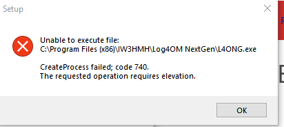

I have down load and installed Ver: 2.28.0.0. and i Get Unable to execute File. C:\Program file (86)\iw3hmh\Log40M NextGen\L40NG.exe. I found the file and it did not have the exe so I added it. now the program starts.

Seems that windows security is blocking, check to see if the folder or files are read only or protected.
Check firewall is not blocking
Try running the software as an administrator
Its all about user permissions in windows

this is what I have done.
I looked to see if the files here C:\Users\Ve3ryi\AppData\Roaming\Log4OM2. was read only, and they will not change to be not-read.
I looked in C:\Program Files (x86)\IW3HMH\Log4OM NextGen. it the same. The EXE file is set to run
as administration. I have it I am the administration all the time.
I have turned off all the window security and fire wall. uninstalled Log40 and Downloaded/reinstalled.
same thing going on.
I founded when I reinstalled the program all my setting are there but not my log. I was thinking I would be
resetting things backup.
the fun being a ham Learning new things
Mark

Did you set the windows User account control slider to bottom?

Yes it to the bottom. I have tried other log programs and they work ok. lol Its properly me missing one little thing. I'm getting everything work one thing at a time. just not saving log on computer shutdown. my luck.

What is the location of the log file (.sqlite), have you tried saving it in a different location?ve3ryi wrote: 09 Jul 2023, 22:48 Yes it to the bottom. I have tried other log programs and they work ok. lol Its properly me missing one little thing. I'm getting everything work one thing at a time. just not saving log on computer shutdown. my luck.
