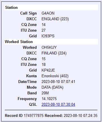

While LOTW seem to have a "work around" to translate DYNAMIC into DATA, then the QSO modes don't match in Log4OM.
Do I also need to reverse the translation for QSLs received in TQSL?
The whole LOTW/data modes business is a mess, especially given the huge number of different data modes and their sub-modes.
Images attached.

The outgoing QSL to LOTW is translated to DATA by the appropriate entry in TQSL. However, in the reverse direction Log4OM rejects the incoming QSL as the modes do not match...
The link to 7821 is for uploading and that works as does the QSL confirmation in LOTW, it's just Log4OM that sees the download QSL as not matching the mode in the log.

VarAC automatically sets the mode to DYNAMIC in Log4OM when it completes a QSO... I have to set TQSL to translate DYNAMIC to DATA as LOTW doesn't accept Vara or DYNAMIC as a mode.
As per my earlier comment, uploading the QSO details as DATA to LOTW works in the outward direction, however it is not a match in Log4OM when I receive a QSL from LOTW.

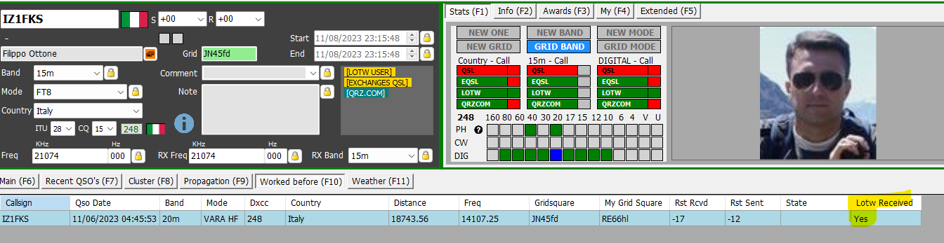

For the VarAC QSO's when I have noted the mismatch on the LOTW download, I have manually updated the original QSO in Log4OM QSO manager, as follows.
It is an inconvenient work-a-round, likewise an ARRL member and have been greeted with silence.
Also, if you sync with QRZ.com to LOTW, despite the correct upload, coming back from LOTW it shows as a "new" extra QSO, as a duplicate.

My Log4OM's modelist.csv contains this line:
VARA HF;VARA HF;DYNAMIC;VARA HF
In TQSL I added a mode mapping from DYNAMIC to DATA.
My Log4OM database includes 117 VARA HF QSOs. 14 of them have "Lotw Yes", so they are confirmed. There was no need to do any manual modification/correction whatsoever.
