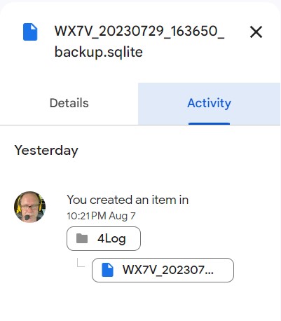

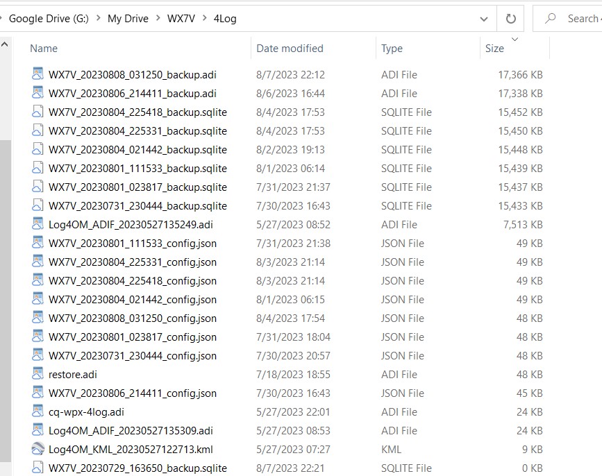

DF5WW- My log is stored on Google Drive. I suspect a bug is creating a new SQLITE database with the old file name. Here's more detail. I have a little more than 9k QSOs in my log (SQLITE database) and have been running Log4OM without admin privileges. The database is about 17MB is size when all QSOs are loaded (or reloaded from ADIF file I had exported as I did last night). I restart Log4OM daily for weeks and everything works as expected. Once in a while on a restart I get the database configuration popup (open/test/new) window with my old log file prepopulated. I pick OPEN, SAVE & Apply. Normally it works. Sometimes there are no QSOs and the database file link is 0KB.
For the past week I've been using the database with file name 'WX7V_20230729_163650_backup.sqlite'. Last night on restart (Log4OM was sluggish during the OMISS 40M NET) I got the database configuration pop. 'WX7V_20230729_163650_backup.sqlite' was defined, I clicked open, save and apply. I had no QSOs. I went to google drive, the file size was 0KB, and when I click on manage versions there are no previous versions. So I'm back to thinking Log4OM is creating a new SQLITE database with the old file name?

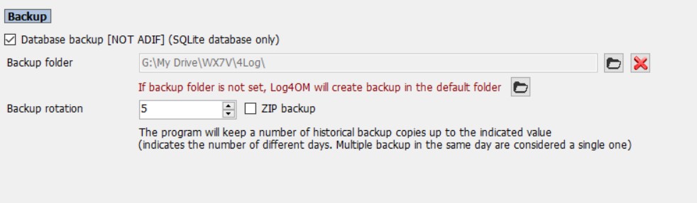

G4POP - I do have the database backups [Not ADIF] (SQLITE database only) option set in the configuration. Maybe the location of the backups is the problem? There are backups for sure, but they didn't have the last 5 QSOs from last night (I did not do a manual backup, as I was in a hurry to continue logging).

Chris,G4POP - I do have the database backups [Not ADIF] (SQLITE database only) option set in the configuration. Maybe the location of the backups is the problem? There are backups for sure, but they didn't have the last 5 QSOs from last night (I did not do a manual backup, as I was in a hurry to continue logging).
First a couple of points....
1. I would set your backup rotation to at least 10, so that even with multiple restarts your unlikely to overwrite them all.
2. I would set a secondary ADIF backup to another location like the documents folder on the hard drive, again with at least 10 rotations and save to zip file.
