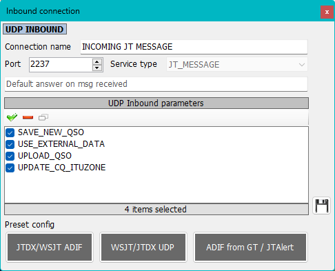

Posts: 11605
Re: Flashing Mode & s/r Signal Report
You need to renew your UDP connections to the FT8 software ensuring that the options below are checked - this is covered in previous release notes, social media and forum notices and posts and in the updated user guide.
NOTE: Use whatever UDP Port number you were previously using
K8TJM
Posts: 30
Joined: 18 Jul 2023, 11:25
Post by K8TJM »
I reconfigured my "connections" and am pleased to report that beta no longer switches back and forth and is working as expected. I'm still trying to get the auto upload to work.
