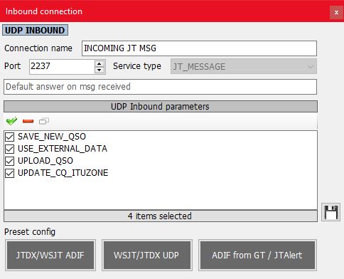

Since you noted using V 2.28.0.0 ... did you delete and rebuild your UDP Inbound Connections as noted in the Release Notes for V 2.27.0.0 ??
There are options inside those rebuilt UDP Inbound Connections that will advise Log4OM what to do with respect to the external services uploads for the QSOs brought in from the FTxx APPs. I've added an image of those options inside the "rebuilt" UDP Inbound Connections ... depending upon which elements you may select.
Reading this post and the one, where you replied to Terry, I'm guessing that you use the QSL Manager to 'manually' upload and download your QSOs to LOTW. This as opposed to the 'automatic upload on close of Log4OM' ???

If it is V 2.27.0.0 or newer (current release is: V 2.29.0.0) you will need to delete and rebuild your UDP Inbound Connections and make choices inside those connections to address QSO uploads, etc.. See image I included in post above to Fred.
FWIW I don't use the "Requested" option for dealing with QSO uploads, etc.. I keep it simple (for me anyway) and just use "Yes" or "No". If you like you can select such in the Configuration section for Confirmations and External Services / LOTW. Should you make such a change you can then also tweak the Requested label to Yes or No in the QSL Manager panel.
Also ... is this impacting the QSOs you are getting via an FTxx APP through the UDP Inbound Connection port? If so you may not have deleted and rebuilt the UDP Inbound Connections ... depending upon which version of Log4OM you are using. See 2nd graf above.
