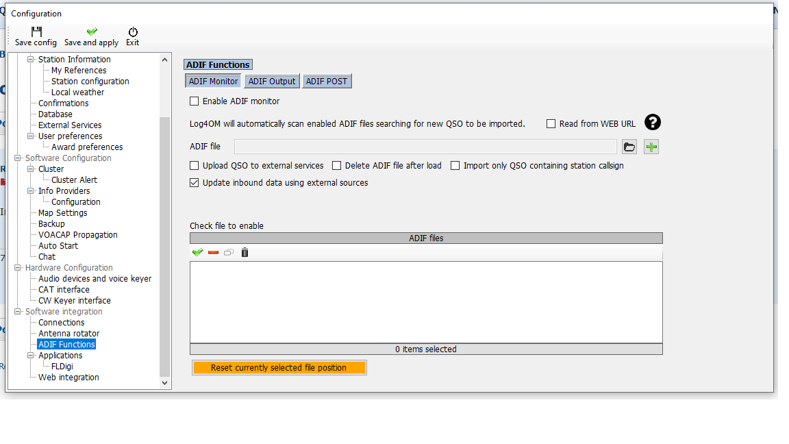

Double on logging
Posts: 11582
Re: Double on logging
In Log4OM show me the ADIF monitor menu in connctions
iz6gvc
Posts: 68
Joined: 04 Mar 2014, 17:56
Post by iz6gvc »
Hope are this:
ADIF Monitor.png (42.9 KiB) Viewed 6021 times
73s, Camillo
Posts: 11582
What are the WSJT logging/reporting settings?

Posts: 11582
Sorry for delay I have not been well
No it does not answere reason but somewhere your sending QSO twice to Log4OM, probably from WSJT as in your last screenshot, but also JTAlert or Gridtracker?
To clear the dupes in the log
1. Export an ADIF
2. Create a new empty database
3. Import the ADIF that you exported but in the import window set 'Duplicate threshold' to 60 sec
