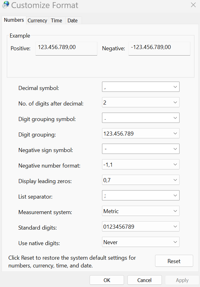

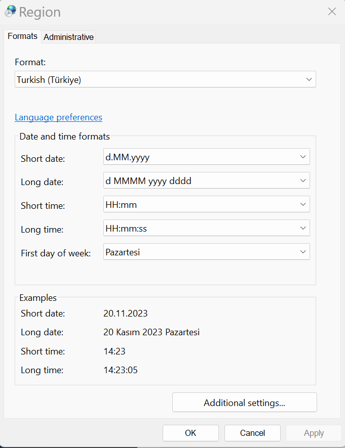

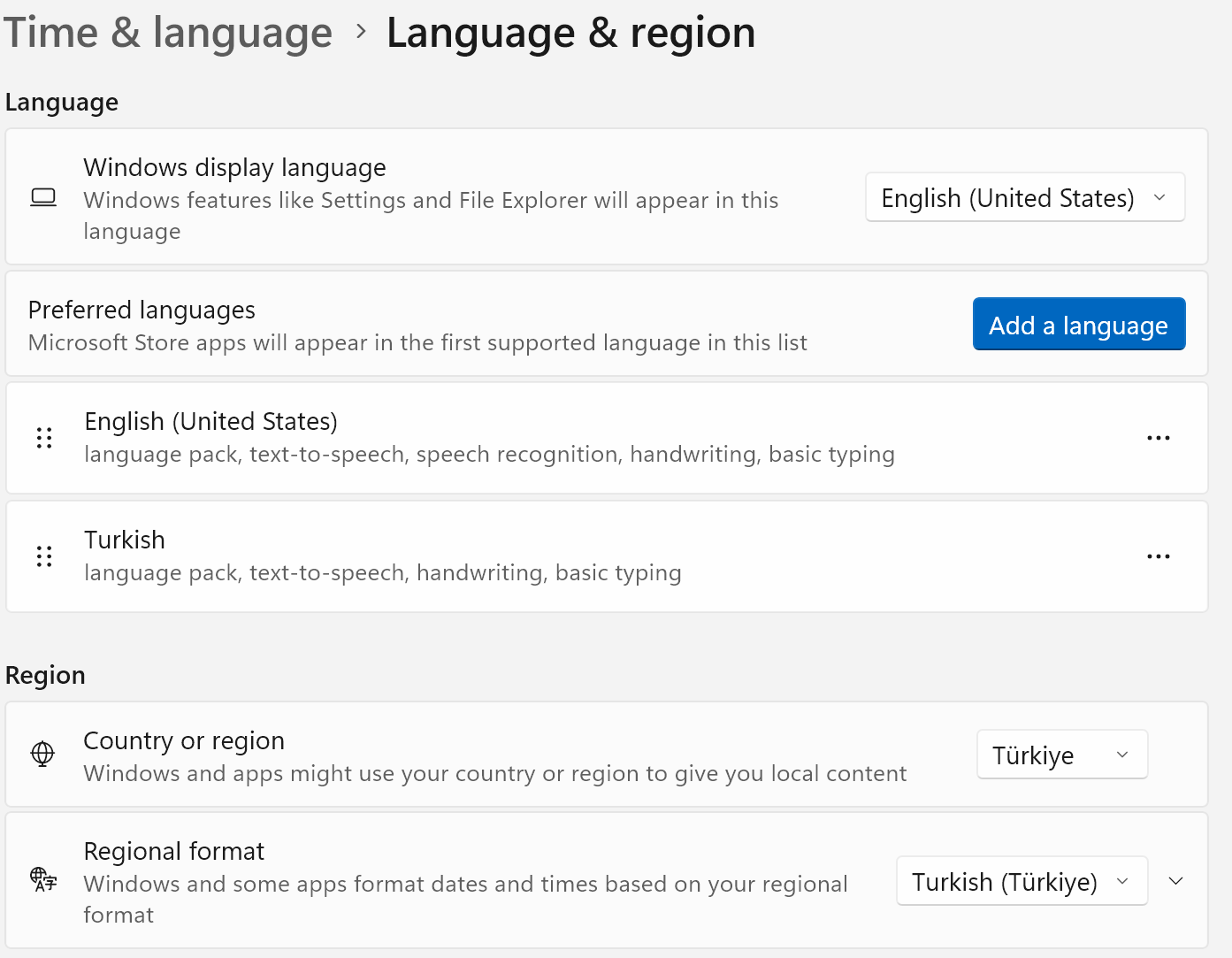

In fact, my windows is English. Region is Turkey only.
I'm attaching a screen capture.
I want to use this great software. Your help will be appreciated.
Best Regards,
Serdar

Hi Again,
My region format in windows is like that:
