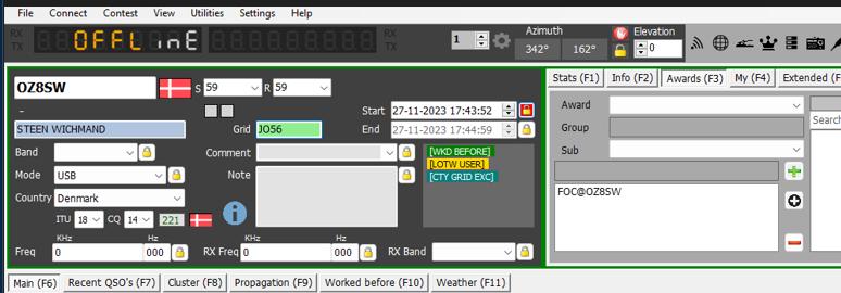

Re: Member of Clubs?
Hi
Thanks for reply
i did make a FOC award with all the FOC members.
When i do enter a call in the log the only place i can see if they are member of FOC are in the award tab ..see attached ...
But here all the worked FOC members show up, and not only the one i do work right now ...
How to make it so i can see ...is he or is he not member of FOC ....
in N1MM the history file show up with name and FOC number just below the callsign IF he is member of FOC ..
Mabye i did something wrong but can not find anything in the manual ..
Best regards
Jalmar
OZ8CW
Thanks for reply
Best regards
Jalmar
OZ8CW
- award1.png (98.79 KiB) Viewed 9582 times
