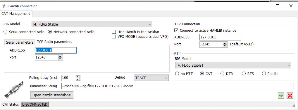

I can't set the CAT/hamlib from log4om to work with the above setup.
- In log4om / CAT management I selected CAT engine - hamlib / autostart.
- In Hamlib I selected RIG Model: FLRig Stable.
- I don't know what settings to do next for Flrig in the Hamlib window or in FLrig setup menu (serial parameters / TCP Radio parameters / TCP Connection, etc).
Atached is my hamlib setup.
When I click un green ok (V) in right lower corner, CAT status: Disconnected indicator turns green "Connected" for 1-2 seconds then turns off.
I also try to click "open hamlib standalone", then ok (V) with the same results (connected only 1-2 seconds).

Setup log4om + hamlib + flrig

I was able to make this work with Log4OM2 2.24.0.0 and FLRig 1.4.7 (and WSJT-X 2.5.4). Here's a brief overview of what I did:
= Install and configure FLRig and make sure it works.
Obviously, FLRig needs to be working 100% before you start trying to make Log4OM2 talk to it...
For me, I simply had to set the proper Rig (FT-450D), COM port (3), Baud (4800) and StopBits (1).
= (Optional) Configure WSJT-X to use FLRig.
I did this next for a couple of reasons: there were a lot more people using this combination successfully, so it was a good way to make sure that the networking side was working correctly. And if I couldn't make WSJT-X work with FLRig, there was no point in continuing. This was also very easy: set the Rig to FLRig FLRig.
= Configure Log4OM2
Open the program configuration. Navigate to the CAT interface page. On the Settings tab, select CAT Engine: Hamlib. On the Hamlib tab, select RIG Model: FLRig FLRig Stable. On the used parameter string, use the following: "--model=4 -Z" (without the quotes) and then Save and apply.
This was the part that I could not initially make work. After a fair bit of Googling and experimenting, I figured out why: if you use the Generated parameter string, rigctld will not start, whether you pick Serial connected radio or Network connected radio. Because we're not actually connecting Hamlib to a radio: we're connecting it to FLRig, and Hamlib already knows how to do that without a bunch of parameters. So let it do it!
Of course, after I figured this out, I went back over some of the info I had previously reviewed and found that one of them mentioned this obliquely ( viewtopic.php?t=3371 ) They also mention replacing a bunch of Hamlib files with newer ones, but the version included with my Log4OM2 is 4.4, which seems to be new enough.

Thank you! Ignoring the generated string and replacing it with your suggested string did the trick (on my IC7300 and FT817). Tnx es best 873 de Paul PA2PWM
