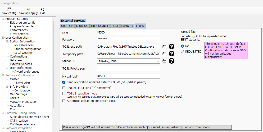

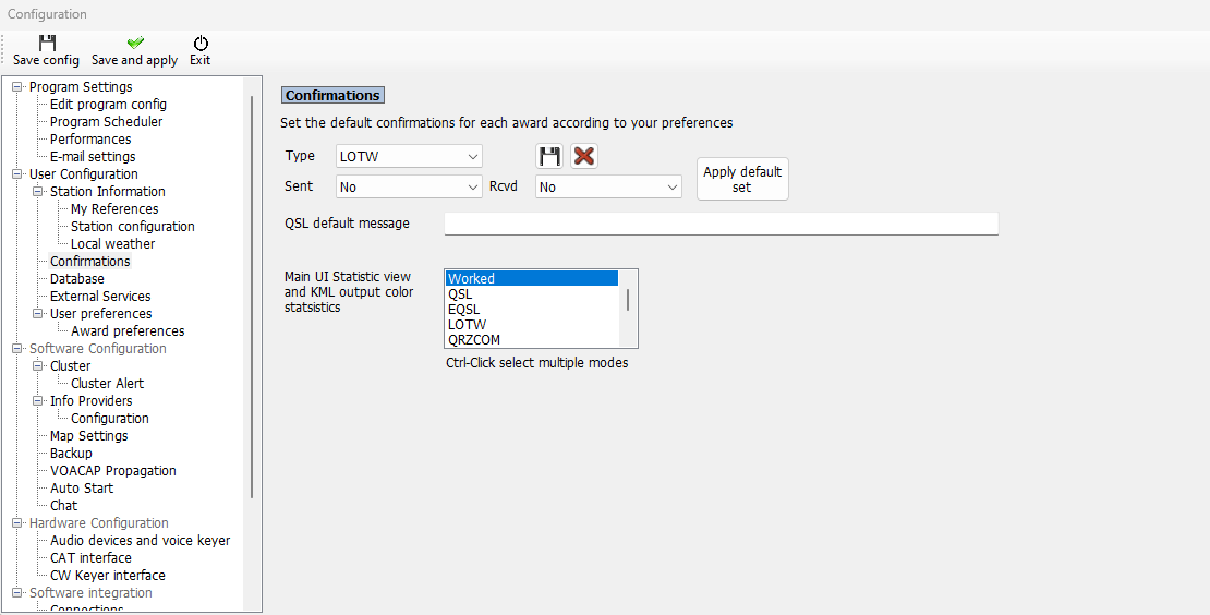

Posts: 1955
Re: V2.32.1.0 Stalls during shutdown
Hans,
Check out Page 112 of the "current" User Guide as it goes into the confirmations settings.
You might have a couple things working against one another, but I'm not sure.
I don't use the 'Request' option for dealing with my QSOs. I'm kind of old-school in that I use "Yes" it has been sent or received and "No" it has not been sent nor received.
An OM can choose either method of using Yes/No/Requested, but it has to be consistent.
Below are screen clips of my settings for Confirmations and note that you also have to have the option noted under your LOTW tab. Of course when you 'manually' upload/download to LOTW (or any source) you have to change the options located in the drop-downs to match your settings.
I also never use the "auto-upload" for any service as I prefer to keep my fingers/eyes on my uploads and downloads.
