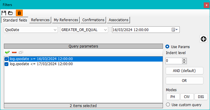

In QSO manager I want to filter the following
QSO date Greater 25/03/24 16:00 QSO date Smaller 25/03/24 18:00
and
QSO date Greater 27/03/24 15:15 QSO date Smaller 27/03/24 16:09
Here Is what I have below but it does not return any QSO's within the filter date/times.
Filter by date.JPG (44.95 KiB) Viewed 2179 times

Use greater_or_equal and smaller_or_equal - Works for me fine

I see your comment but I want to filter by a block of times on each day so greater_or_eqaul or smaller_or_equal will not help me.
Between 16:00 to 18:00 on one day
and
Between 15:15to 16:15 on another day

Use the same search syntax but double up for different blocks, can't demo for you as I am away from pc using phone

Did you think to use the lgic 'OR' ?
