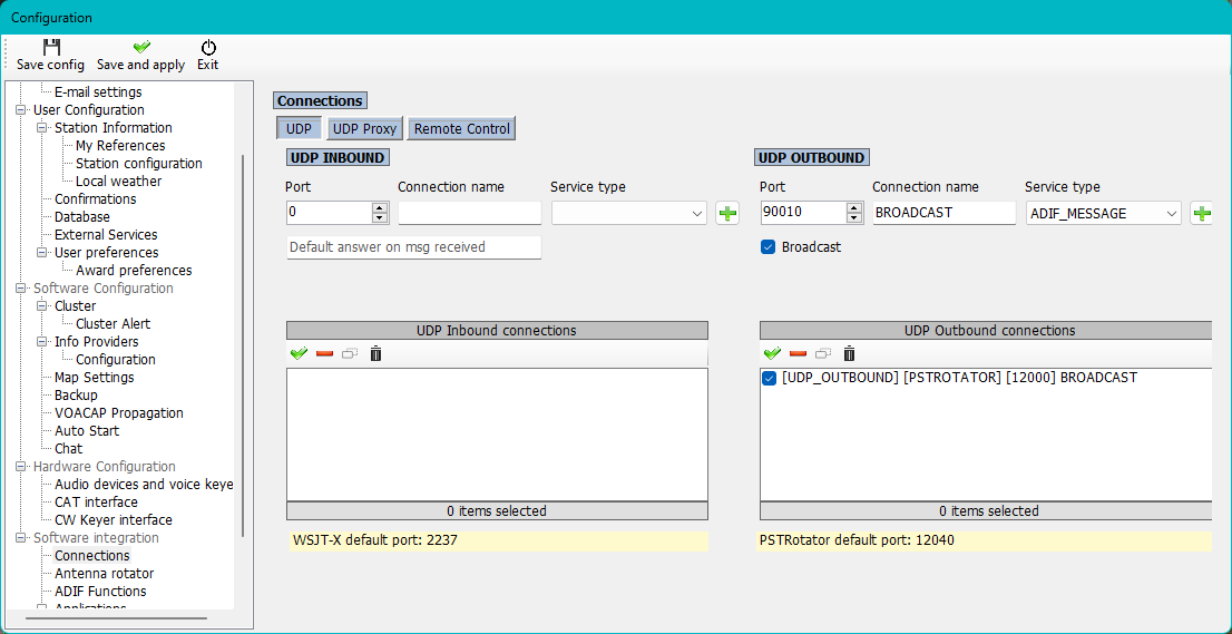

Hi there,
I´m using an RF2K-S solid state amp. It has serveral network connections and the capability to grab the frequency for switching the amp via UDP broadcast.
With the current UDP service types I couldn´t get it working. The RF-Kit manual can be found here: http://www.rf-kit.de/files/User_Manual_ ... NG_V14.pdf. Page 25 describes the UDP setup.
Thanks in advance and thanks for the nice job!,
Joe

Those interested in this facility should contact me for an Alpha version for testing Broadcast
Email is on QRZ

I'm painfully late to comment but the UDP Broadcast works perfectly with my Node-Red Flow to get the N1MM formatted Radioinfo UDP message.
I use it with a YCCC MOAS II antenna switch and all I had to do was enable the broadcast in LOG4OM and change the port number in the Node-Red node that was receiving the N1MM UDP message.
Now I can use 1 radio directly with LOG4OM in non contest use.
Thank You!!!
