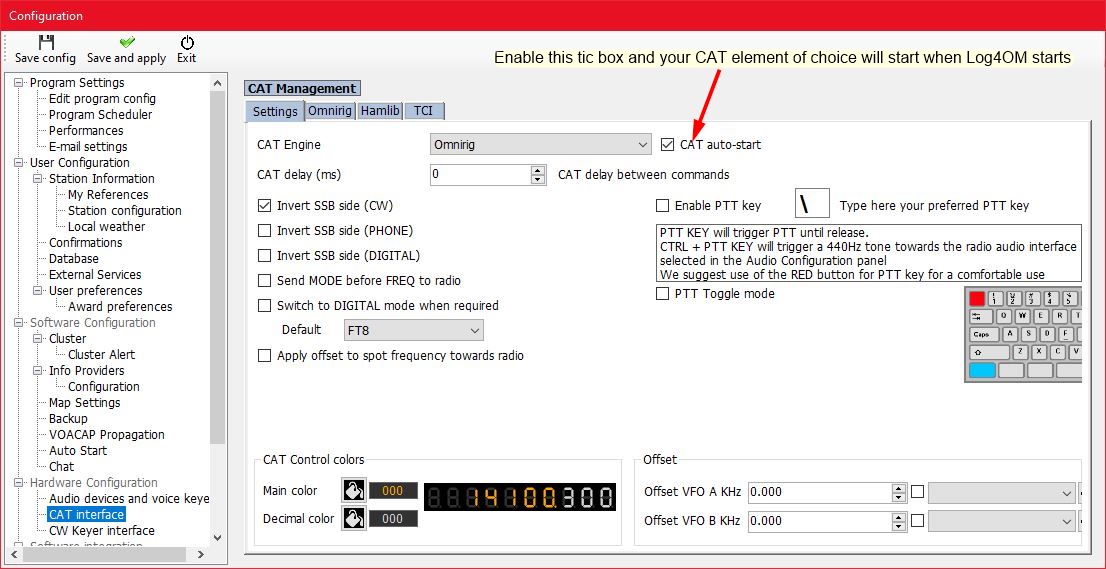

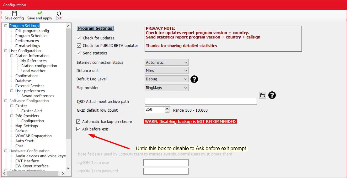

When I happen to run Log4OM, etc.. with Admin privileges I don't get any extra prompts to do so. I simply adjust the Taskbar or Start Icon to run with Admin Levels. Once I'm done with having the need to run with those elevated levels I will change it back to "non-admin" levels.
If you are getting additional prompts when running any APP with Admin Level settings then such is related to the level you have chosen for your Windows O/S. You can adjust that level under the User Account Control Settings in your Windows O/S control section. Commonly called UAC Settings.
As for the prompt when closing Log4OM and the CAT engine autostart ... both are covered in our extensive User Guide, but to make things easier for you I've included screen clips of those toggles in the Configuration.

- CAT.JPG (110.39 KiB) Viewed 5416 times
- AskExit.JPG (91.17 KiB) Viewed 5416 times
