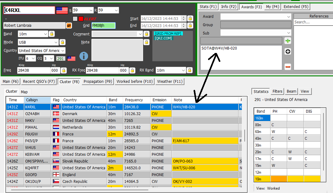

As an example here is the SOTA cluster in Log4OM and you will notice the award reference in the 'Notes' field received from the SOTA cluster is automatically inserted in the awards field when left clicking a call.
The problem is not all SOTA operators or chasers insert the summit reference in the notes field, without that we dont have a clue about them or where they are activating.
