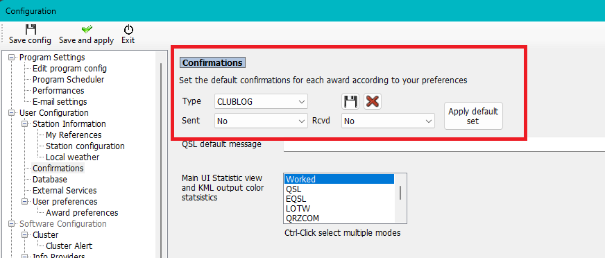

Posts: 11582
Re: Upload to Clublog, etc. after ADIF import?
Then I think the setting shown below is not the same on both PC's

Hi Terry
Sorted, I made both log books the same, with sent showing "requested" on both, that works as expected.
