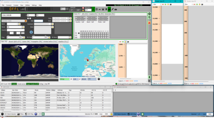

But it already does I just checked with three windows open and closed Log4OM - On restart the same windows re-opened and in the exact same possitions?
Posts: 11591
Re: Save Windows layout
This with main and 4 windows after restart of Log4OM
Screenshot 2024-09-27 144302 new.png (85.99 KiB) Viewed 1430 times
