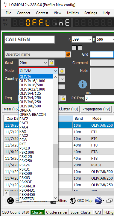

No, they are listed in the drop Mode selection field. I'll see if I can attached a screen shot...
Screenshot 2024-11-08 104731.png (48.98 KiB) Viewed 622 times
