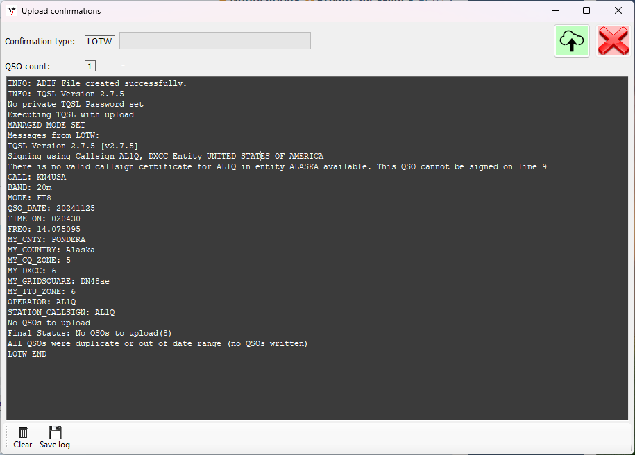

I'm a new user, and I am having an issue uploading to LOTW. When I try, I get this error message:
Signing using Callsign AL1Q, DXCC Entity UNITED STATES OF AMERICA
There is no valid callsign certificate for AL1Q in entity ALASKA available. This QSO cannot be signed on line 9
For some reason, MY_COUNTRY for the upload is set to ALASKA. That's consistent with my callsign, but I have long since moved from Alaska, and my ULS record is current as to my current QTH.
I can't find where in the LOG4OM settings that I might change this field. So I don't know if this a LOG4OM issue, or a LOTW certificate issue.
To be clear, this is a new LOTW certificate, issued in the last week or so; I was on hiatus from seeking QSOs for a couple of years.

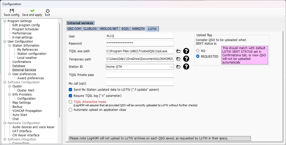

My LOTW settings are:

Sounds like the offending qso is marked that you were in Alaska, find the qso and edit your location
Use the qso manager and filters

Thank you, that worked. The upload through QSL manager worked.

Program Config/Station info for future QSO's
Update existing in bulk using QSO manager
